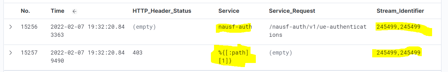

I need to copy contents of :path field from No. 15256 into the :path field of No.15257 if Stream_Identifier of both lines in 15256 and 15257 are matching.
Kindly suggest how to get this done in the conf file of logstash or any other way to achieve the same
Please refer to the image/snippet attached for the above query. Also attached is snippet of the my logstash conf file for ref

Thanks Badger for your time and prompt reply. I incorporated the suggestion in the conf file. Snippet given below, however the desired result is not seen
How to write the syntax to compare the Stream_Identifier and if they are equal then copy the contents of Service from 15256 row into the Service field in 15257...
Also in this example the rows where the fields are compared and copied are adjacent, there might be a case where they aren't adjacent how to factor this possibility as well ?
Desired result is to populate contents in Service field in No. 15256 copied to Service filed in No. 15257 as the Stream_Identifier are same for both the rows
I am very new to the ELK world and might be missing some trivial thing here. Please suggest

Hi Badger
I have tested the above aggregation code however the field content of Service from No 15256 to No 15257 is not getting populated.
