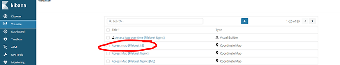

Hi guys,
Using Elastic Stack : 6.4.0
I am currently reading in IIS logs and trying to get geoIP filtering to work with Kibana, however I am quite stuck at the moment.
When navigating to:
The following message is diplayed:
Could not locate that index-pattern-field (id: iis.access.geoip.location)
Moreover, the following errors are displayed when navigating to Dashboard:
I suspect that geoIP might be causing trouble. I have tried to follow the related topic:
But was unable to follow through, more specifically, how to access and specify/modify index templates in Windows.

the visState for Access Map [Filebeat IIS] Visualization Object:

  "title": "Access map [Filebeat IIS]"

That's suggesting that the index pattern defined for the dashboard is iis.access.geoip.location, so it's not talking about the field.
What does _cat/indices?v show?
