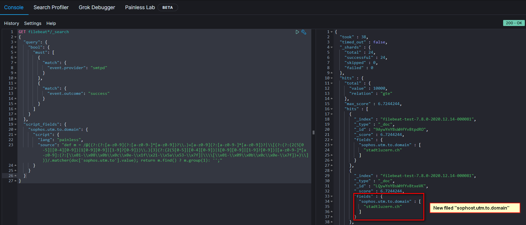

I got a query which creates a new field sophos.utm.to.domain. That query extracts the full mail domain. The mail address which is stored in sophos.utm.to.
My Question: How do I create a new field out of this query?
See the new runtime fields feature of mappings

OK so I think I got it working, using "scripted fields".
I put following script as painless:
if (doc['sophos.utm.to'].size() == 0) return '';
Matcher m = /@([\.\w\-_]+\.[a-zA-Z]+)/.matcher(doc['sophos.utm.to'].value);
return m.find() ? m.group(1): '';
