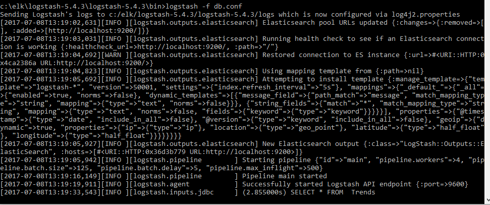

Thanks for your replay !
After the configuration i created db.conf and i get this result

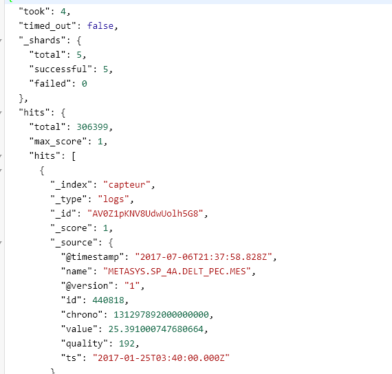

I don't understand why it only shows me 5 lines but in the database it exits 400000 lines!
You have probably the first 10 docs. Not 5.
yes You're right i have to change the result number in query editor. And to display the results with kibana how I can do please ?
