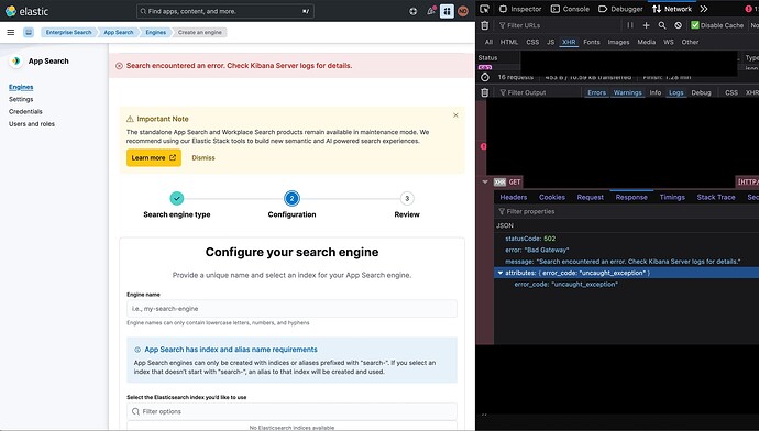

When using Elasticsearch App Search we need to create index-based engines, but when we go to search for the index on GUI we encounter a 502 error. It seems to be because of the Index-searching box as it comes up with 0 results; whereas in our Prod environment this process works fine.

Here is a screenshot of what ES is displaying

Yes, the problem occurred on 8.7 before we upgraded and is still occurring on 8.18.1 after we upgrade (as you can tell by the banner in the screenshot)

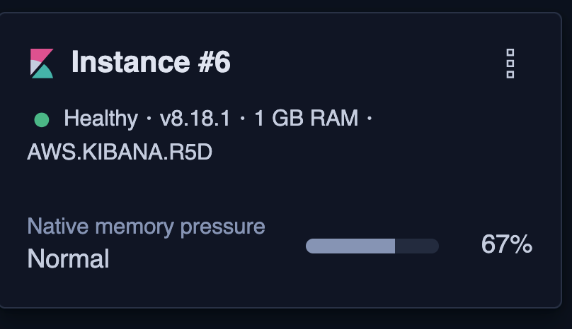

We did the upgrade through the upgrade-assistant/elastic cloud so I believe everything is the same version:

@ndesanto - thanks for the additional context - I did not realize that you were on an Elastic Cloud hosted environment... if you used the upgrade dialogues through that, then you should be on the same versions for all components...
