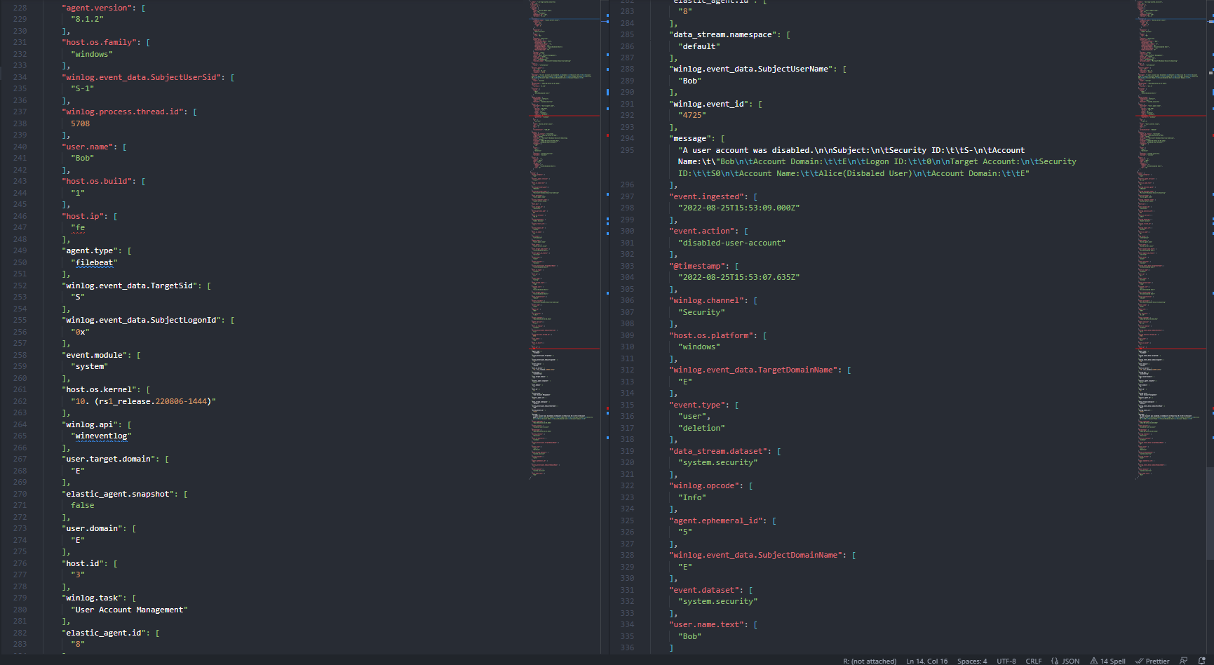

Hey,
I have attached the details of the log-in below screenshot with some of the private values changed.
And I tried the query in the Dev tools as you suggested and got a valid response but not many details.
Thanks and let me know your thoughts.

Can you send data for a 4625 event?
Hi, again.
Thanks for the follow-up
There is no IAM event in 4625, the category for that is authentication (line 129). Attaching the screenshot for your reference.
