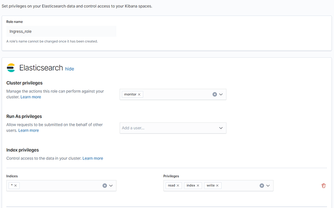

I was creating custom user via Kibana for writing logs to elastic purpose only.
Firstly I specify custom role ->
Then I map new user with this role.

Thanks for the additional information. What response does your c# application get from Elasticsearch when you try to write the logs?
Is the application writing to an existing index, or is the application supposed to create its own index? If it's creating its own index, then you'll also need to grant the create_index index privilege. See https://www.elastic.co/guide/en/elastic-stack-overview/current/security-privileges.html for an explanation of available privileges
Larry, adding 'create_index' helps me.
And I think i need review my app. Add some try-catch block while connecting to elasticsearch.
Thanks a lot!
