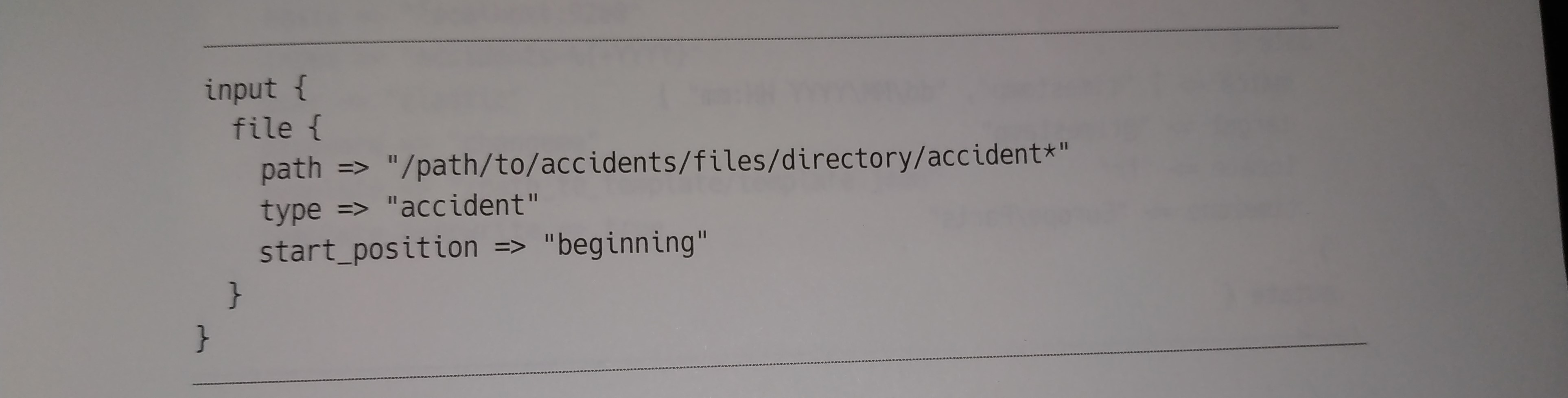

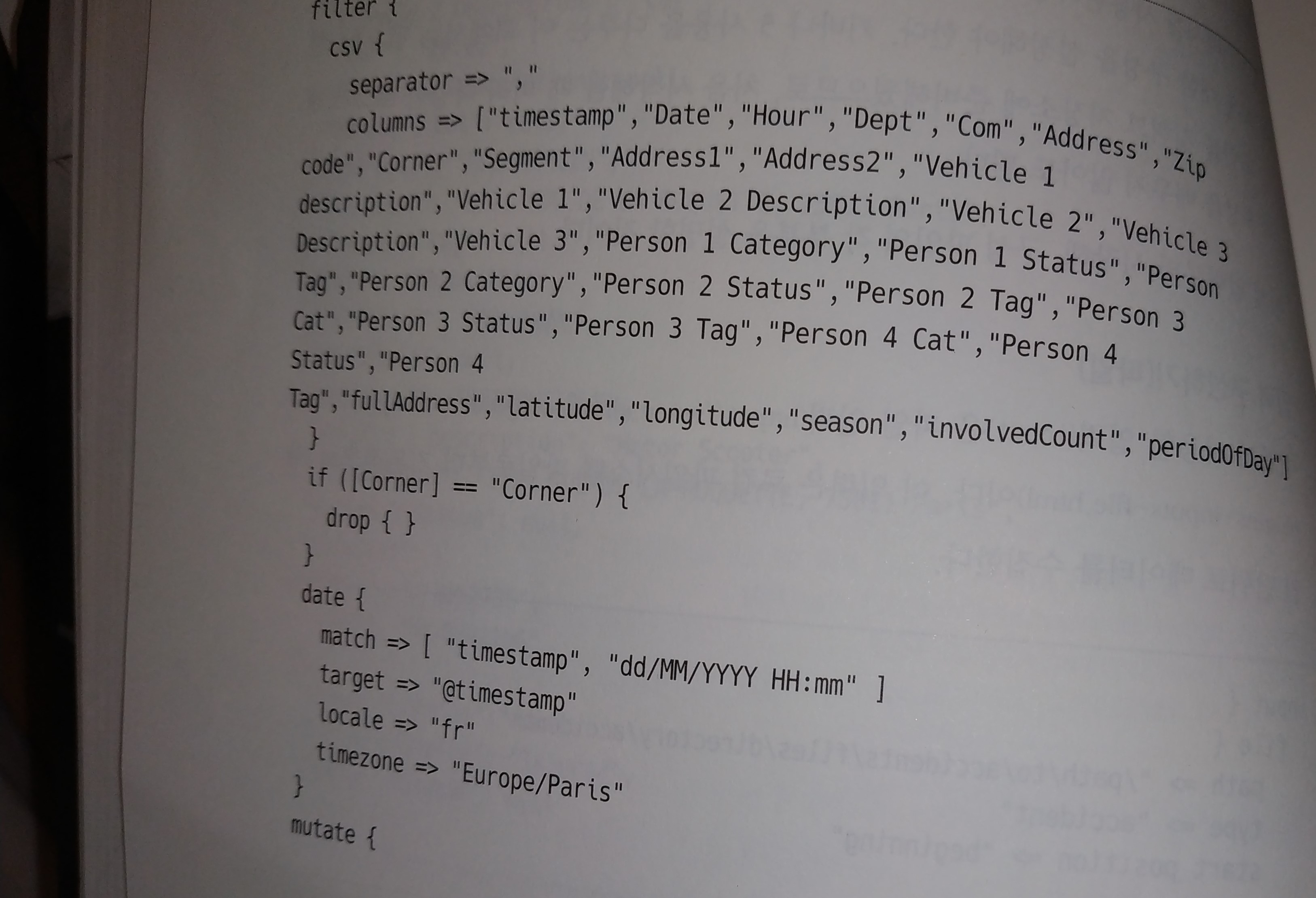

First one is my data and the second is json type of data
Third picture is my input method and the last is filter.
Did you print it then took a picture? Unbelievable!
Please don't post images of text as they are hardly readable and not searchable.
Instead paste the text and format it with </> icon. Check the preview window.
