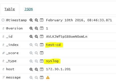

I search the data using kibana and indexes are created using abc-* and xyz-*, but using old syntax yyymmdd is the same. When I explode found records I found _index:abc and type:xyz which is impossible in my idea.
When I have to find some data I must try on each index in kibana and I found it in any index...
What am I doing wrong?
Some files are as simple as being collectd five-liners...
Here is data from syslog collector (listening on udp 514) that went into the collectd index (test-cd) listening on 25826.
Thanks
What does you Logstash config look like?

If you have multiple outputs and do not use conditionals in your configuration, Logstash will send each event to all outputs.

Ok, maybe I got something more.
Are you saying that if I put 10 .conf files in the conf.d directory they are considered as a big one? In that case I need to put a conditional in front of each output like
if type1 then output 1
if type2 then output 2
I thought that each file lived in its own "domain". I saw several examples of different files run by the daemon and noone noted cross inputs.
The syslog file above should be written as
output {
if [type]=="syslog" {
 elasticsearch {
  hosts => localhost
  index => "syslog-%{+YYYY.MM.dd}"
So that if it is run as a single file it behaves normally, and when run with other files it will output only "its own" events. Is this right?
Yes, that is correct. Logstash will read all config files in the directory and basically concatenate them, which is why conditionals in output and filter blocks are essential when modularising configuration.
Thank you, I totally misunderstood the meaning of having different files. I'm rewriting my conditions right now.
And of course it is working as expected now. Thank you.
