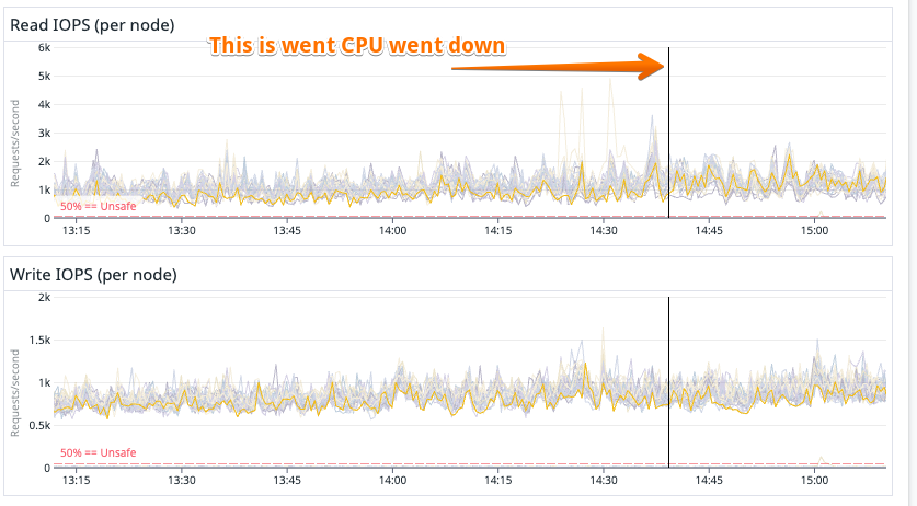

These are the read and write IOPS of the cluster during this time. There are a few spikes nothing elevated
These are the read and write IOPS of the hot node. Read IOPS seems to be increasing but there's no change in the write IOPS.

Our cluster has 30 data nodes and 25 indices. 18 indices have 30 primary and 30 replica shards while the rest 7 indices have 20 primary and 40 replica shards. This ensures that all the shards are evenly balanced among all the data nodes.
We noticed the CPU on one of the data nodes started to increase again and search rate on this node decreased.
We decided to disable Adaptive replica selection to see what will happen if all the data nodes receive search traffic in round-robin.
We noticed that CPU spiked even more on the hot node and another data node also became hot.
The search rate became even as expected.
We also noticed that the search queue started to fill on the hot node.
Any idea what might be wrong and what we should investigate next? @DavidTurner can you help here? :raised_hands:
