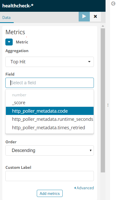

Hello all.
I'm developing a custom visualization (Angular-Visualization).
My gol is using the "top hit" aggregation and keep the last entry of a field of type String.
This is what happens: I select "top hit" as aggr but in the fields list only fields of type "number" are shown. Where are the string fields? .
I tried to replicate the same thing on the core-visualization: data-table; over there it works.
On the same index of course...
I posted 2 photo too.
I'm in your hands. Ty.
Hi Marco,
unfortunately, this hasn't been solved the best possible way, when this aggregation was introduced and is currently hard-coded to allow string values only for table and metric vis explicitly, see top_hit.js.
Please feel free to open a feature request for that on our repository, that we find a better way to let each vis configure that itself.
Sorry, for that news.
Cheers,
Tim
