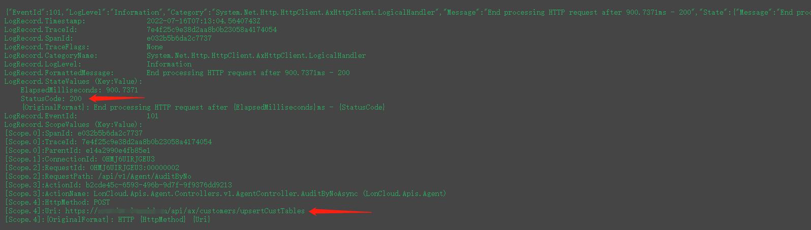

I checked the frontend's log, its status code is 200, which means the request was successful, but I can't find any request records from the frontend on kibana
