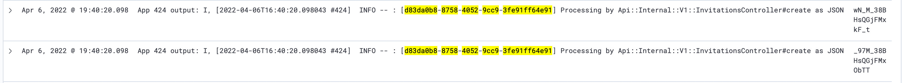

I have an issue:
Logs injects more than one time.
It has different IDs but log contains the same data:

I've never worked with fluentd but it seems as the same event is pulled or pushed multiple times this can happen if you have multiple harvesters that ingest from the same source or the system sends the event multiple times. Because the UUID generation is different for the same event: My approach with the fingerprinting below always creates the same hash based on the same content originating from the source fields.
Quick workaround:
You could create in your ingest pipeline a custom fingerprint based on one or more source fields (message, field.other, etc.) and use as the target the "_id" field. So identical events will have the same hash value based on the combination of the content of the source fields specified
The disadvantage is you loose the optimized UUID generation for the "_id" field that can impact performance and storage.
