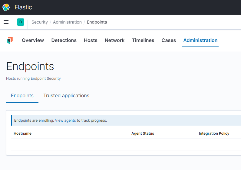

Hello,
Tried to install an Elastic Agent on my home Windows 10. Deployed the Agent through fleet.
with a system, windows and endpoint policy.
But when I go to Security Administration, it says "Endpoints are enrolling. View agent to track progress."
I also don't see any endpoint indices in my cluster.
So what else do I need to do to see my endpoint in the security app?
Grtz
Willem
Ha, found it, my output setting was incorrect...
Changed from http://localhost:9200 to:
And I can see data now. :slight_smile:
