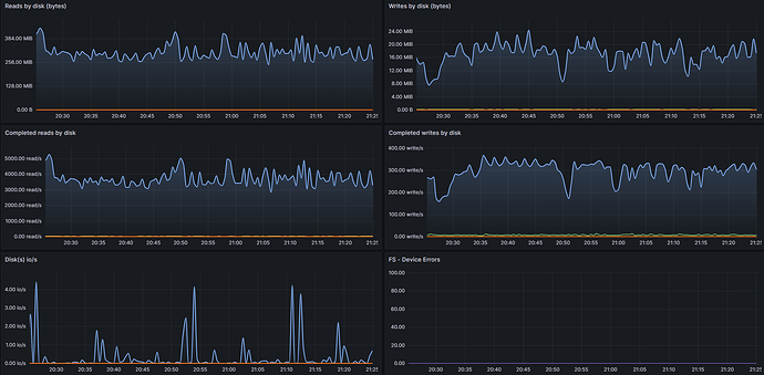

The disks are busy but don't seem overloaded:
...so I cannot understand why there are so many major page faults being reported?

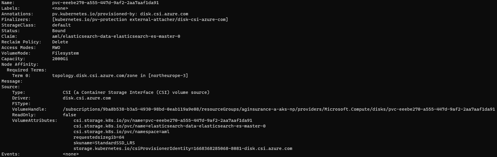

We are using PVC disks of type StandardSSD_LRS - here is the specification:
