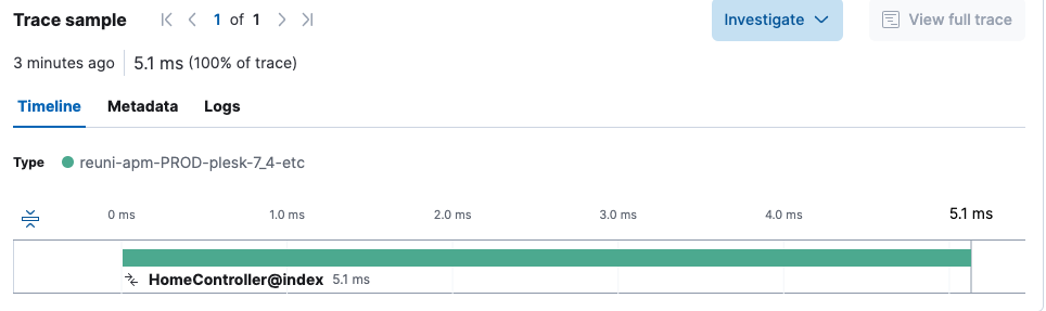

Adding to this, I tried to force Laravel to find ElasticApm compiled classes, so I copied it to laravel folder, renaming namespace to make it be found.
Actually it dit found classes after this, but the transactions data was not complete,
it just register the name of transaction:
(production)
Screen Shot 2023-03-29 at 09.46.29
While in my container it shows every request:
(development) - I want that in production it logs as much as this
Screen Shot 2023-03-29 at 09.47.45

With this snippet I get different results from dev and prod when I click in route /test:
in dev I do have HTTP data (notice the GET /test)
Screen Shot 2023-03-30 at 22.17.29
but in prod, don't
Screen Shot 2023-03-30 at 22.18.08
If you noticed, I'm getting the ElasticApm class from App\Elastic\Apm, not from Elastic\Apm as documentation says.. thats because I've copied the classes and changed namespace to force my app in prod to find the files..
At first I thought that was the reason for incomplete data, but I did the same in dev and worked nicely..
The platform I'm using in prod is Plesk and yes, I've checked all the configs I could use to make it work (php.ini, environment variables), but did not make it collect HTTP data
