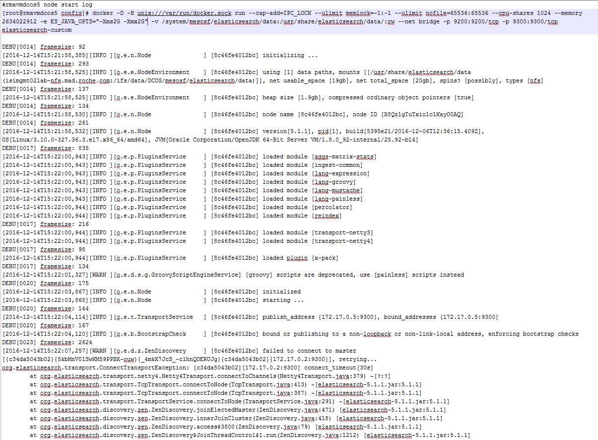

[root@rmavmdcos4 config]# docker build --tag=elasticsearch-custom .
When I ran;
[root@rmavmdcos4 config]# docker -D -H unix:///var/run/docker.sock run --cap-add=IPC_LOCK --ulimit memlock=-1:-1 --ulimit nofile=65536:65536 --cpu-shares 1024 --memory 2634022912 -e ES_JAVA_OPTS="-Xms2G -Xmx2G" -v /system/mesosf/elasticsearch/data:/usr/share/elasticsearch/data/:rw --net bridge -p 9200:9200/tcp -p 9300:9300/tcp elasticsearch-custom
The cluster starts and its accessible
But when I ran same command on second node(rmavmdcos5), it fails reporting
DEBU[0023] framesize: 2624
[2016-12-14T15:22:07,257][WARN ][o.e.d.z.ZenDiscovery     ] [8c46fe4012bc] failed to connect to master [{c34da5043b02}{5kbMnV01SwKM59PPBX-ouw}{4mkX7JcS-clhnQOERUJg}{c34da5043b02}{172.17.0.2:9300}], retrying...
org.elasticsearch.transport.ConnectTransportException: [c34da5043b02][172.17.0.2:9300] connect_timeout[30s]
at org.elasticsearch.transport.netty4.Netty4Transport.connectToChannels(Netty4Transport.java:379) ~[?:?]
Problem seems to be that the elastic nodes are running on IP's like 172.17.0.x, and the information detailed on unicast.host are the real IP of the virtual hosts
Anyone knows how to set the unicast host or adapt the elasticsearch.yaml file in order to make both nodes see each other?
