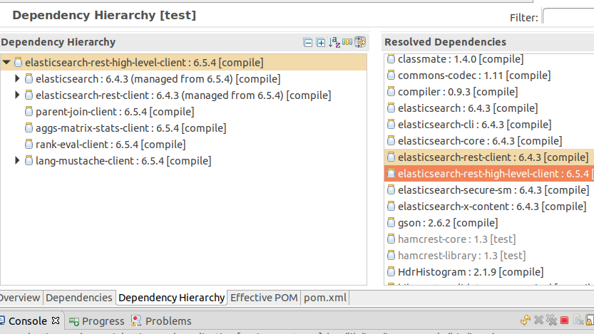

I am using below dependency -
       <dependency>
           <groupId>org.elasticsearch.client</groupId>
           <artifactId>elasticsearch-rest-high-level-client</artifactId>
           <version>6.5.4</version>
       </dependency>
And its showing an warning near version as - "Overriding managed version 6.4.3 for elasticsearch-rest-high-level-client" in the pom.xml
What gives
mvn dependency:tree
sorry didn't get you.
Run the command I shared and share the output
I have attached the dependency hierarchy and the dependency which I have used in pom.xml. But I can't understand why its showing elasticsearch : 6.4.3 (/manged from 6.5.4) but I didn't used 6.4.3 anywhere.
Screenshot%20from%202019-04-02%2018-40-17
That's not what I asked for.
Anyway, you can see that you need to fix your pom.xml. Most likely this is coming from spring boot you seem to be using.
Actually I didn't understand that properly ,I thought you are asking for the dependency hierarchy. so could you please tell me once again what you want? and how to run this command

[INFO] \- org.elasticsearch.client:elasticsearch-rest-high-level-client:jar:6.5.4:compile
[INFO]    +- org.elasticsearch:elasticsearch:jar:6.4.3:compile

[INFO]    +- org.elasticsearch.client:elasticsearch-rest-client:jar:6.4.3:compile

What is you full pom.xml?
<?xml version="1.0" encoding="UTF-8"?>
<project xmlns="http://maven.apache.org/POM/4.0.0" xmlns:xsi="http://www.w3.org/2001/XMLSchema-instance"
	xsi:schemaLocation="http://maven.apache.org/POM/4.0.0 http://maven.apache.org/xsd/maven-4.0.0.xsd">
	<modelVersion>4.0.0</modelVersion>
	<parent>
		<groupId>org.springframework.boot</groupId>
		<artifactId>spring-boot-starter-parent</artifactId>
		<version>2.1.2.RELEASE</version>
		<relativePath/> <!-- lookup parent from repository -->
	</parent>
	<groupId>com.example</groupId>
	<artifactId>search-service</artifactId>
	<version>0.0.1-SNAPSHOT</version>
	<name>search-service</name>
	<description>Demo project for search-service</description>
	<properties>
		<java.version>1.8</java.version>
	</properties>
	<dependencies>
		<dependency>
			<artifactId>spring-boot-starter-web</artifactId>
		</dependency>
		<dependency>
			<artifactId>spring-boot-starter-thymeleaf</artifactId>
		</dependency>
		<dependency>
            <groupId>org.json</groupId>
            <artifactId>json</artifactId>
            <version>20180813</version><!--$NO-MVN-MAN-VER$-->
        </dependency>
		<dependency>
           <groupId>com.google.code.gson</groupId>
           <artifactId>gson</artifactId>
           <version>2.8.2</version><!--$NO-MVN-MAN-VER$-->
        </dependency>
        <dependency>
			<version>2.6.2</version><!--$NO-MVN-MAN-VER$ -->
		</dependency>
		<dependency>
			<artifactId>spring-boot-devtools</artifactId>
			<scope>runtime</scope>
		</dependency>
		<dependency>
			<artifactId>spring-boot-starter-test</artifactId>
			<scope>test</scope>
		</dependency>
		<dependency>
       </dependency>
	</dependencies>
	<build>
		<plugins>
			<plugin>
				<artifactId>spring-boot-maven-plugin</artifactId>
			</plugin>
		</plugins>
	</build>
</project>
This is happening because of:
    <parent>
    </parent>
When you remove it, you get:
[INFO] com.example:search-service:jar:0.0.1-SNAPSHOT
[INFO]    +- org.elasticsearch:elasticsearch:jar:6.5.4:compile
So I think you need to explicitly import the elasticsearch:jar:6.5.4.
I reproduced it from my own projects. It's annoying that spring boot now (from 2.1) sets in the stone the elasticsearch version to use IMO.
For example, here is what I did for version 7.0:
Thank you for your reply. For now I have used java low level rest client to achieve the requirements. OR else
To force load elasticsearch 6.5.4 I have added the following property to my pom which will override the property defined in spring-boot-dependencies pom
<properties>
    <elasticsearch.version>6.5.4</elasticsearch.version>
</properties>
<dependencies>
    <dependency>
        <version>${elasticsearch.version}</version>
    </dependency>
</dependencies>
