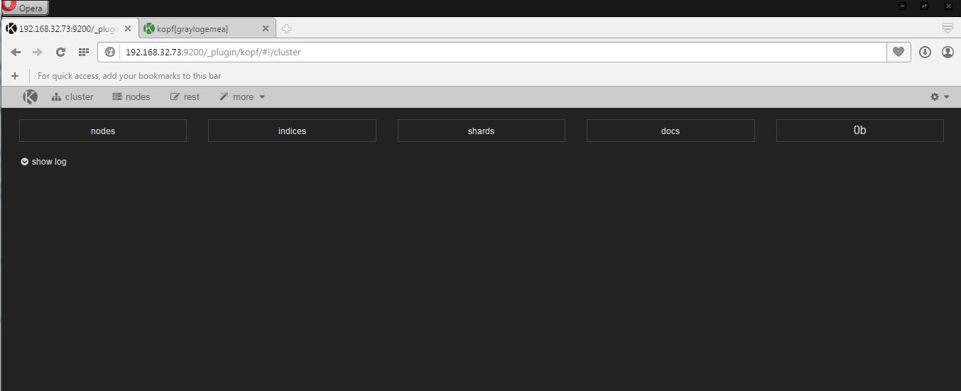

(This picture shoes KOPF from Gray-003. It can see Gray-006 and see its stats)
However, KOPF on Gray-006 says its offline (192.168.32.73)
After a few minutes or so it connects back up and KOPF identifies itself again.
