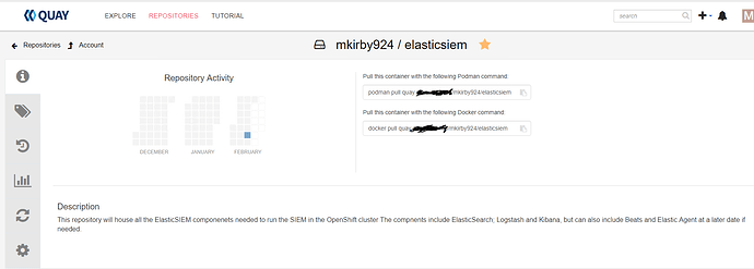

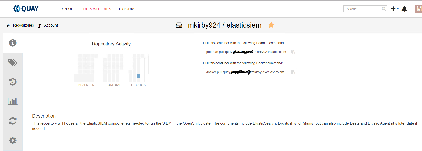

The above error is shown on all three pods and it does not matter if I use the docker pull or the podman pull from our internal quay website.
I uploaded the image for Elasticsearch 8.11.4 from a linux machine connected to the quay using
podman tag <image_id> quay.our.internal.ca:8443/mkirby924/elastticsiem:elasticsearch
podman push --tls-verify=false quay.our.internal.ca:8443/mkirby924/elasticsiem:elasticsearch
I verified that the file made it up to our internal quay server.
I am not sure what is wrong with my install, but it should be find from everything I have seen. I have even tried with 2 seperate quay repositories
