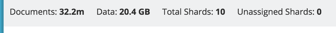

Online environment Documents: 394.9k Data: 242.9 MB of elasticsearch-version:5.4.0
