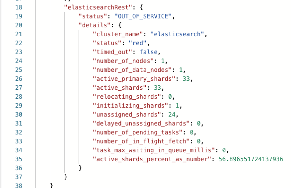

Hi guys, I'm an intern at my software engineering company adding a health endpoint (using Spring Actuator) to our API for our Elasticsearch service.
I am using POSTMAN to view the JSON response and it's sending it correctly, but listing Elasticsearch as "OUT_OF_SERVICE":

Upon further inspection, I found when I boot up ./elasticsearch from local on the terminal (Mac) , it is throwing some errors for "failed to recover translog" , which another developer indicted to me might be the issue. It's a pretty big log. Is there a way to upload or copy and paste it here to get some help?
