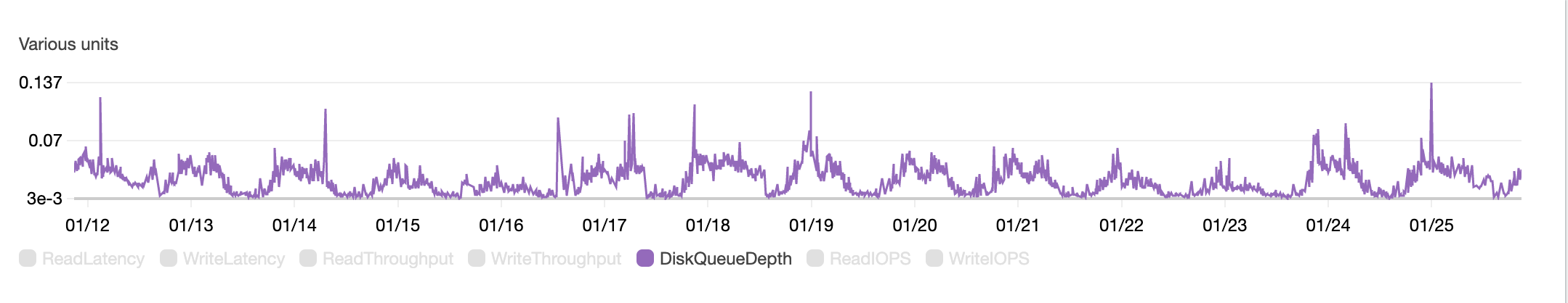

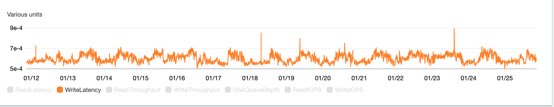

Storage Type is "Elastic Block Storage" And "EBS volume type" is SSD (general Purpose)
Read Latency:
Write Latency:
Read Throuput:
Write througput:
Disk Queue depth:
Read IOPS:
Write IOPS:
Past 2 weeks stats
