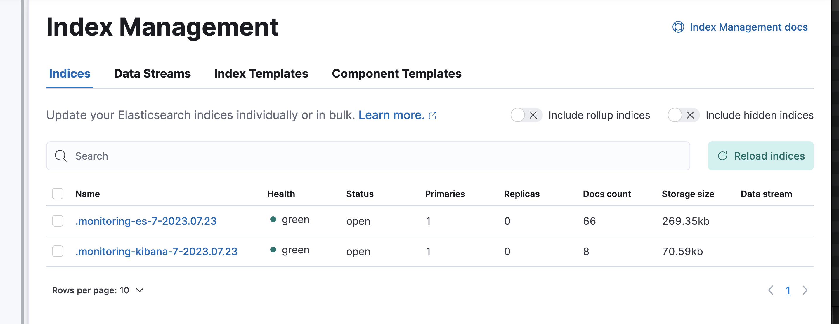

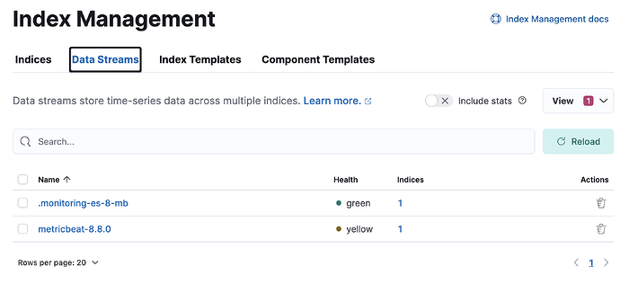

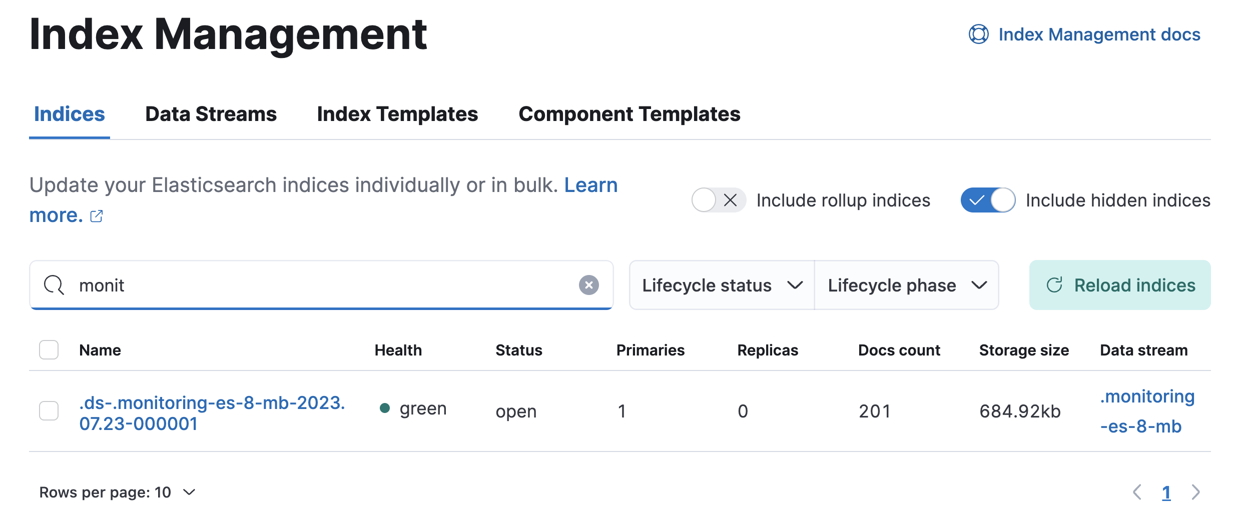

Also if I am reading this right 1 cluster is self-monitoring (deprecated) and one cluster is using metricbeat easlticsearch-xpack module (go forward method).... not sure that is the best setup.... that could be a problem as well and I believe that monitoring indices are different.
Not saying that IS the issue... but not sure if you can mix them.
Self Monitoring Indices...
Metricbeat Monitoring
Datastream + backing indices

Ohh and you might need to clean up the old monitoring indices
