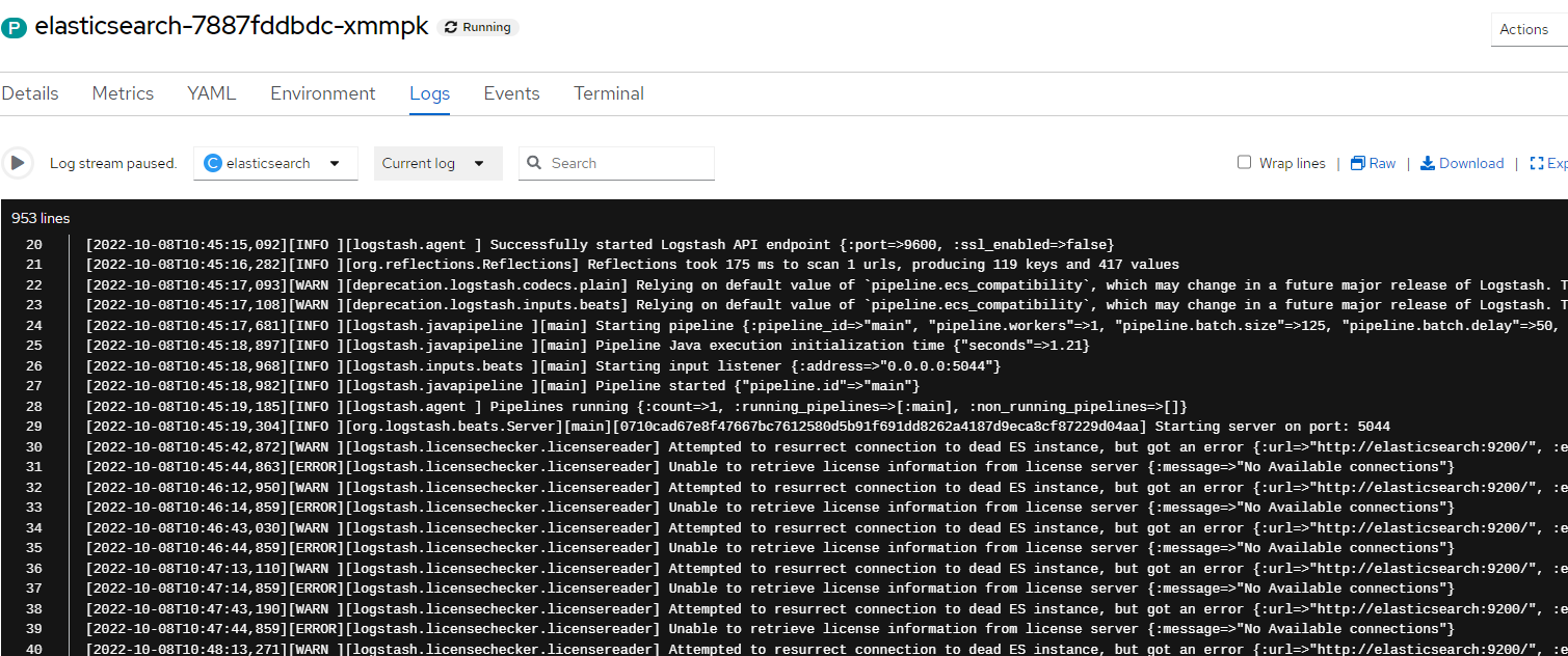

hello this is console with eleastic instance
[2022-10-08T10:45:14,844][WARN ][logstash.licensechecker.licensereader] Marking url as dead. Last error: [LogStash::Outputs::ElasticSearch::HttpClient::Pool::HostUnreachableError] Elasticsearch Unreachable: [http://elasticsearch:9200/][Manticore::SocketException] No route to host (Host unreachable) {:url=>http://elasticsearch:9200/, :error_message=>"Elasticsearch Unreachable: [http://elasticsearch:9200/][Manticore::SocketException] No route to host (Host unreachable)", :error_class=>"LogStash::Outputs::ElasticSearch::HttpClient::Pool::HostUnreachableError"}
18[2022-10-08T10:45:14,848][ERROR][logstash.licensechecker.licensereader] Unable to retrieve license information from license server {:message=>"Elasticsearch Unreachable: [http://elasticsearch:9200/][Manticore::SocketException] No route to host (Host unreachable)"}
19[2022-10-08T10:45:14,871][ERROR][logstash.monitoring.internalpipelinesource] Failed to fetch X-Pack information from Elasticsearch. This is likely due to failure to reach a live Elasticsearch cluster.
20[2022-10-08T10:45:15,092][INFO ][logstash.agent ] Successfully started Logstash API endpoint {:port=>9600, :ssl_enabled=>false}
21[2022-10-08T10:45:16,282][INFO ][org.reflections.Reflections] Reflections took 175 ms to scan 1 urls, producing 119 keys and 417 values
22[2022-10-08T10:45:17,093][WARN ][deprecation.logstash.codecs.plain] Relying on default value of `pipeline.ecs_compatibility`, which may change in a future major release of Logstash. To avoid unexpected changes when upgrading Logstash, please explicitly declare your desired ECS Compatibility mode.
23[2022-10-08T10:45:17,108][WARN ][deprecation.logstash.inputs.beats] Relying on default value of `pipeline.ecs_compatibility`, which may change in a future major release of Logstash. To avoid unexpected changes when upgrading Logstash, please explicitly declare your desired ECS Compatibility mode.
24[2022-10-08T10:45:17,681][INFO ][logstash.javapipeline ][main] Starting pipeline {:pipeline_id=>"main", "pipeline.workers"=>1, "pipeline.batch.size"=>125, "pipeline.batch.delay"=>50, "pipeline.max_inflight"=>125, "pipeline.sources"=>["/usr/share/logstash/pipeline/logstash.conf"], :thread=>"#<Thread:0xa863158 run>"}
25[2022-10-08T10:45:18,897][INFO ][logstash.javapipeline ][main] Pipeline Java execution initialization time {"seconds"=>1.21}
26[2022-10-08T10:45:18,968][INFO ][logstash.inputs.beats ][main] Starting input listener {:address=>"0.0.0.0:5044"}
27[2022-10-08T10:45:18,982][INFO ][logstash.javapipeline ][main] Pipeline started {"pipeline.id"=>"main"}
28[2022-10-08T10:45:19,185][INFO ][logstash.agent ] Pipelines running {:count=>1, :running_pipelines=>[:main], :non_running_pipelines=>[]}
29[2022-10-08T10:45:19,304][INFO ][org.logstash.beats.Server][main][0710cad67e8f47667bc7612580d5b91f691dd8262a4187d9eca8cf87229d04aa] Starting server on port: 5044
30[2022-10-08T10:45:42,872][WARN ][logstash.licensechecker.licensereader] Attempted to resurrect connection to dead ES instance, but got an error {:url=>"http://elasticsearch:9200/", :exception=>LogStash::Outputs::ElasticSearch::HttpClient::Pool::HostUnreachableError, :message=>"Elasticsearch Unreachable: [http://elasticsearch:9200/][Manticore::SocketException] No route to host (Host unreachable)"}
31[2022-10-08T10:45:44,863][ERROR][logstash.licensechecker.licensereader] Unable to retrieve license information from license server {:message=>"No Available connections"}
32[2022-10-08T10:46:12,950][WARN ][logstash.licensechecker.licensereader] Attempted to resurrect connection to dead ES instance, but got an error {:url=>"http://elasticsearch:9200/", :exception=>LogStash::Outputs::ElasticSearch::HttpClient::Pool::HostUnreachableError, :message=>"Elasticsearch Unreachable: [http://elasticsearch:9200/][Manticore::SocketException] No route to host (Host unreachable)"}
33[2022-10-08T10:46:14,859][ERROR][logstash.licensechecker.licensereader] Unable to retrieve license information from license server {:message=>"No Available connections"}
34[2022-10-08T10:46:43,030][WARN ][logstash.licensechecker.licensereader] Attempted to resurrect connection to dead ES instance, but got an error {:url=>"http://elasticsearch:9200/", :exception=>LogStash::Outputs::ElasticSearch::HttpClient::Pool::HostUnreachableError, :message=>"Elasticsearch Unreachable: [http://elasticsearch:9200/][Manticore::SocketException] No route to host (Host unreachable)"}
35[2022-10-08T10:46:44,859][ERROR][logstash.licensechecker.licensereader] Unable to retrieve license information from license server {:message=>"No Available connections"}
