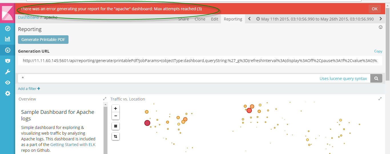

Max attempts reached (3)
There was an error generating your report for the "apache" dashboard: Max attempts reached (3)

if the reporting have a map. the kibana server need connect to es maps services with network or it use the local maps ? i can't reporting it output Max attempts reached (3)
