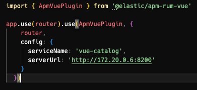

RUM in Vue:
Screen Shot 2023-06-16 at 16.13.28

Just to add as much information as needed, the console warn points to a request from Vue.. but the request works correctly:
