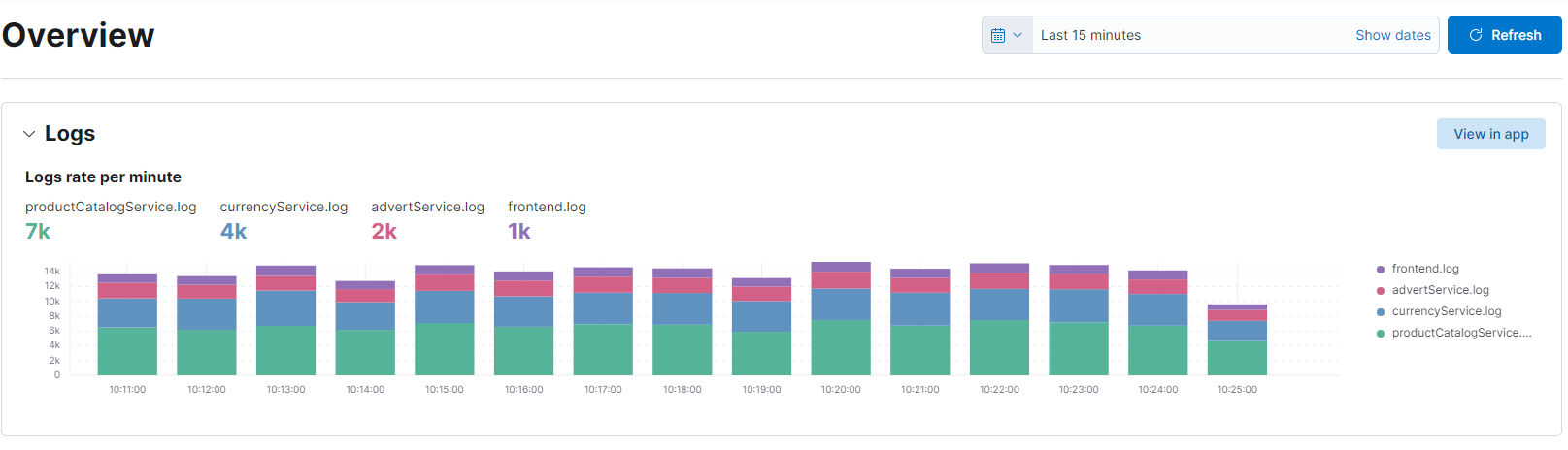

Hey, I am using Docker-desktop 4.6.0 (75818) on windows 10 [version 10.0.19042.1526], trying to set up Observability in a Kubernetes context, I have two application running (spring boot application + react app) I set up apm agent for each application and an APM server to collect metrics, everything is working fine, but when I deployed a filebeat to collect logs from all pods (including logs from Elasticsearch), all logs are 'unknown' (see picture below):
What I would like is something similar to (I took this screenshot from CTB workshop) :

what's causing the 'unknown' in Logs UI ? And how to collect Elasticsearch logs (gc, audit, etc.) with filebeat in kubernetes? I already did this configuration but was on-premise not in kubernetes.
Thanks.
Well based on the two issues: issue1 and issue2, it appears that filebeat only collect raw logs but doesn't assign from which source it was collected, thus you have to add event.dataset, see ECS: event.dataset field using processors, like this:
  processors:
      - add_cloud_metadata:
      - add_host_metadata:
      - add_kubernetes_metadata:
      - add_fields:
          when:
            contains:
              kubernetes.pod.name: "my-app1"
          target: ''
          fields:
            event:
              dataset: my-app1.log
      - add_fields:
          when:
            contains:
              kubernetes.pod.name: "my-app2"
          target: ''
          fields:
            event:
              dataset: my-app2.log
      #- add_field for more pods, etc.
