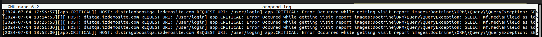

Hello, i have installed elk in an aws ec2 instance ubuntu and filebeat in another ubuntu instance.
Below is my filebeat.yml file
cat /etc/filebeat/filebeat.yml

here is my logstash conf file. I have tried with the output to elasticsearch it was not showing anything in kibana so i have used
stdout {
codec => rubydebug
here where i got that it was not receiving any logs .
cat /etc/logstash/conf.d/oroprod.conf
input {
beats {
port => 5044
filter {
grok {
match => {
"message" => "\[%{TIMESTAMP_ISO8601:timestamp}\]\[%{DATA:loglevel}\] %{GREEDYDATA:message}"
grok {
match => {
"message" => "HOST: %{HOSTNAME:host} REQUEST URI: %{URIPATH:request_uri}"
output {
stdout {
codec => rubydebug
here is the output it got stuck there it was not printing anything error also
bin/logstash -f /etc/logstash/conf.d/oroprod.conf

below is my log entry
[2024-06-26 06:56:53][][ HOST: distqa.izdemosite.com REQUEST URI: /user/login] app.CRITICAL: Error Occured while getting visit report images:Doctrine\ORM\Query\QueryException: SELECT mf.mediaFileId as id, CONCAT(mf.rootPath, mf.mediaFileName) as url FROM IZMOMediaLibraryBundle:MediaFile mf WHERE mf.mediaFileId = in /websites/distrigoboost/crm-application/vendor/doctrine/orm/lib/Doctrine/ORM/Query/QueryException.php:41 Stack trace: #0 /websites/diost/crm-application/vendor/doctrine/orm/lib/Doctrine/ORM/Query/Parser.php(448): Doctrine\ORM\Query\QueryException::dqlError('SELECT mf.media...') #1 /websites/distrigoboost/crm-application/vendor/doctrine/orm/lib/Doctrine/ORM/Query/Parser.php(2649): Doctrine\ORM\Query\Parser->syntaxError('Literal') #2 /websites/disst/crm-application/vendor/doctrine/orm/lib/Doctrine/ORM/Query/Parser.php(2837):pplication/vendor/doctrine/orm/lib/Doctrine/ORM/Query/Parser.php(2739): Doctrine\ORM\Query\Parser->ArithmeticFactor() #5 /websites/distrigoboost/crm-apt/crm-application/vendor/doctrine/orm/lib/Doctrine/ORM/AbstractQuery.php(924): Doctrine\ORM\AbstractQuery->exectrigoboost/crm-application/vendor/doctrine/orm/lib/Doctrine/ORM/AbstractQuery.php(804): Doctrine\ORM\AbstractQuery->execute(NULL, NULL) #23 /websites/distrigoboost/crm-application/src/IZMO/MediaLibraryBundle/Entity/Repository/MediaFileRepository.php(128): Doctrine\ORM\AbstractQuery->getSingleResult() #latform/src/Oro/Bundle/UserBundle/Controller/SecurityController.php(99): IZMO\MediaLibraryBundle\Provider\MediaLibrary->getUrlOnLoginPage(NULL) #26 /websites/dist/crm-application/vendor/oro/platform/src/Oro/Bundle/UserBundle/Controller/SecurityController.php(32): Oro\Bundle\UserBundle\Controller\SecurityController->getBadgesInfo() #27 [internal function]: Oro\Bundle\UserBundle\Controller\SecurityController->loginAction() #28 /websites/dist/crm-application/app/bootstrap.php.cache(3242): call_user_func_array(Array, Array) #29 /websites/diost/crm-application/app/bootstrap.php.cache(3201): Symfony\Component\HttpKernel\HttpKernel->handleRaw(Object(Symfony\Component\HttpFoundation\Request), 1) #30 /websites/dist/crm-application/app/bootstrap.php.cache(3355): Symfony\Component\HttpKernel\HttpKernel->handle(Object(Symfony\Component\HttpFoundation\Request), 1, true) #31 /websites/distrigoboost/crm-application/app/bootstrap.php.cache(2540): Symfony\Component\HttpKernel\DependencyInjection\ContainerAwareHttpKernel->handle(Object(Symfony\Component\HttpFoundation\Request), 1, true) #32 /websites/distrigoboost/crm-application/web/app.php(22): Symfony\Component\HttpKernel\Kernel->handle(Object(Symfony\Component\HttpFoundation\Request)) #33 {main} [] []
here in this log entry i no need all things to get parsed i just need the request uri and timstamp log.level that's it so that why i used grok pattern
\[%{TIMESTAMP_ISO8601:timestamp}\]\[\]\[ HOST: %{DATA:host} REQUEST URI: %{DATA:request_uri}\] %{WORD:source}\.%{LOGLEVEL:loglevel}: %{DATA:error_message} %{JAVACLASS:exception_class}: %{DATA:exception_message} in %{DATA:exception_location} Stack trace: %{GREEDYDATA:stack_trace} \[\] \[\]
its giving the correct output in grok debuger why its not displaying anything when i run logstash idk
and there us no filebeat logs in syslog it showing the metric information
