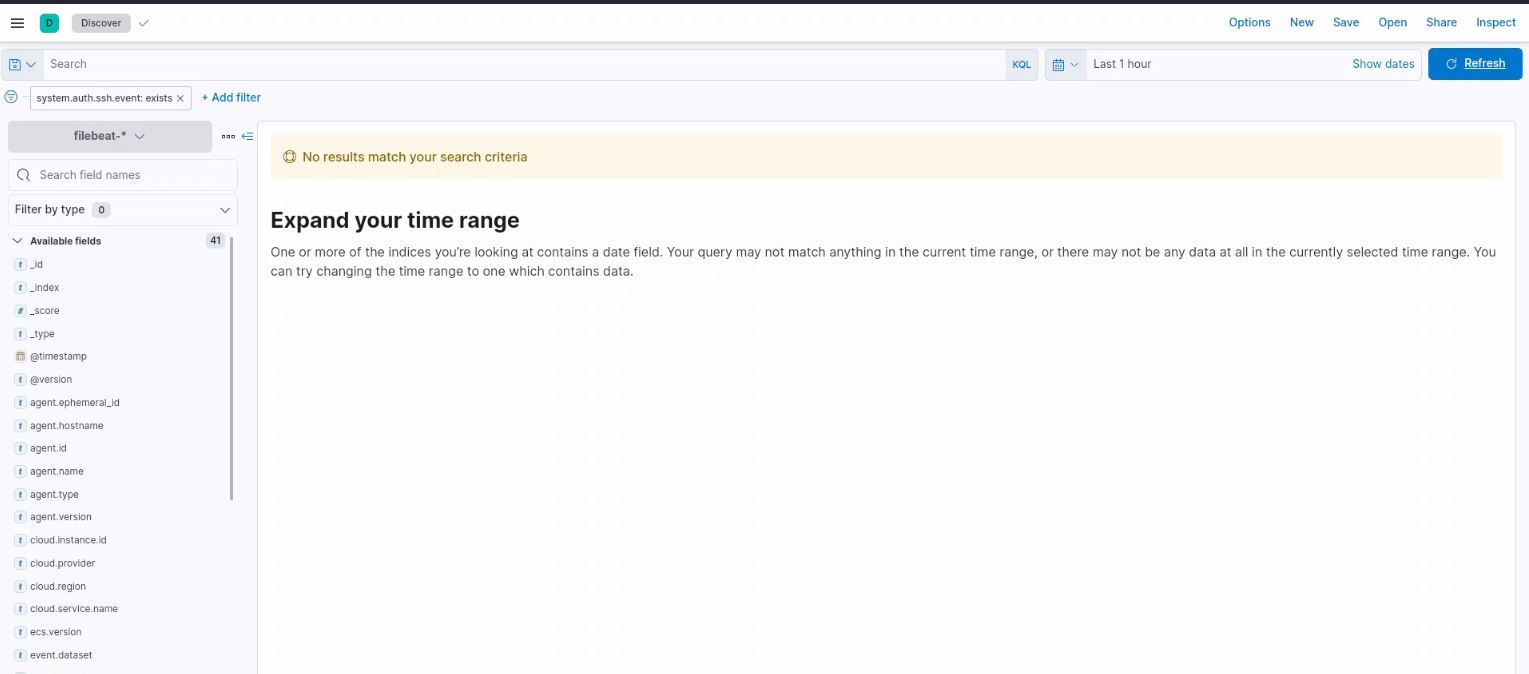

Also, when I tried to lookup data in Discovery and search for system.auth.ssh.events for example I couldn't find anything:
What is the problem?

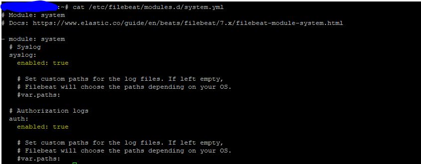

Did u enable the filebeat system module?? You also need to configure the elasticsearch output when u run setup to load the index template, mappings, and ingest pipelines...
@legoguy1000 Sure. I've enabled the system module and configured logstash to read from filebeat input and send to elasticsearch. Please check below:
filebeat modules list
filebeat-modules
cat /etc/filebeat/modules.d/system.yml
cat /etc/logstash/cond.d/beats-input-output.conf
These were setup before running the commands in the original post.
