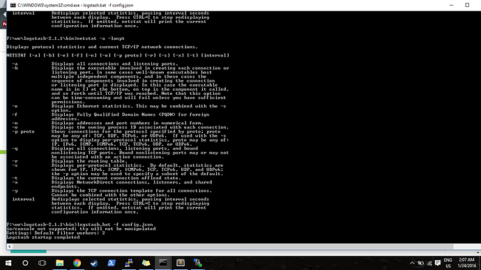

I installed filebeat on my dev server and wanted to fetch log files from there to another machine but when i try to run logstash.bat -f config.json on my elk machine it shows error in my console
←[31mAttempted to send a bulk request to Elasticsearch configured at '["http://http://localhost:9200/"]', but an error occurred and it failed! Are you sure you can reach elasticsea
rch from this machine using the configuration provided? {:client_config=>{:hosts=>["http://http://localhost:9200/"], :ssl=>nil, :transport_options=>{:socket_timeout=>0, :request_ti
meout=>0, :proxy=>nil, :ssl=>{}}, :transport_class=>Elasticsearch::Transport::Transport::HTTP::Manticore, :logger=>nil, :tracer=>nil, :reload_connections=>false, :retry_on_failure=
false, :reload_on_failure=>false, :randomize_hosts=>false}, :error_message=>"http", :error_class=>"Manticore::ResolutionFailure", :backtrace=>["F:/wo/logstash-2.1.1/vendor/bundle/

can someone tell me what exactly is the problem?
Filbeat version 1.0.1 installed on ubuntu server
ELK on windows
ES 2.1.1
logstash 2.1.1
i used the config.json as per the documentation
** logstash:**
** # The Logstash hosts**
** hosts: ["183.83.221.80:5044"]**
** # Number of workers per Logstash host.**
** #worker: 1**
** # Optional load balance the events between the Logstash hosts**
** #loadbalance: true**
my filebeat config
