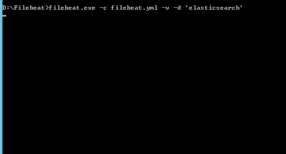

can you run filebeat with elasticsearch output in debug mode with -v -d 'elasticsearch'. By default HTTP connections are re-used (if supported by endpoint) and only closed after some (unconfigurable) time if no HTTP request is run.

oh, windows. Is the ' character passed as to CLI tools or stripped like on unix based shells. Maybe -d elasticsearch works. Can you try with -d '*' instead (how can one pass * as string to command line tools on windows?).
