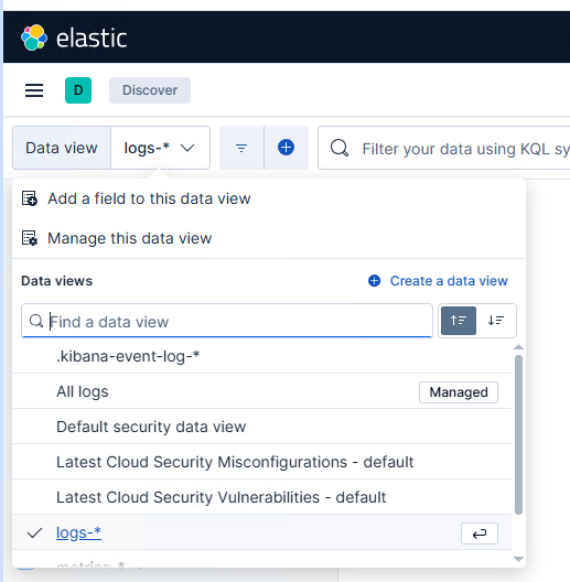

After restarting the service I do not find any filebeat logs in KIBANA:
Have I missed some requested steps?

Did you run filebeat setup -e I suspect you did not therefor the Data View was not created...
I would review the Quick start
In short the logs are probably flowing but you have no data view
You could check in
Kibana - Stack Management -> Index Management - > Data Streams and see if there is one named filebeat-9.0.0
Hi Stephen,
thank you.
Unfortunately, I have no such datastream:
I try with
filebeat setup -e
I did not run it ...
