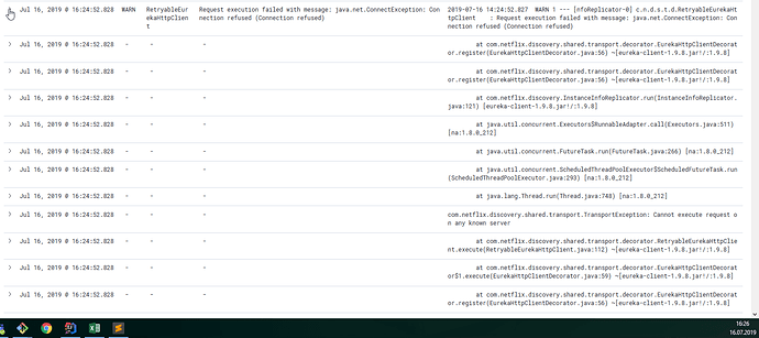

I managed to merge my stacktrace in a mulitline. Unfortunately my kibana still shows me the logs for single error threads. How do I avoid these single logs and get solely multilines?

And it seems to work because in Kibana I got the stack trace shown as 1 log. Unfortunately the single error logs of the stack trace are shown aswell.
I got the merged stack trace on top and underneath the single ones.
