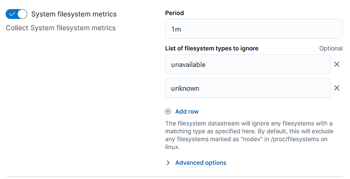

Filesystem.ignore_types - where to configure
I'm configuring this through kibana > fleet > agent policies
As you can see on this screenshot I tried doing the filtering according to the doc but it doesn't change anything, hence why I disabled it

Here's the current config in integration "System":
I have this same problem, I have added unavailable and unknown into my fleet config, but the errors persist. Did anyone ever find a solution to this?
in system agent 2.2.0 this issue should be solved. Fsstat got a new option to ignore filesystem. (previously missing).
