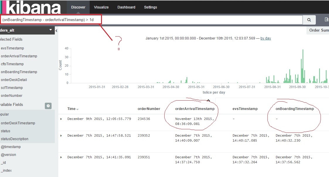

We are capturing order flow data in an Index complete with time stamps of the major order fulfillment events. We want to identify few key orders that are past due.
I want to compare the two time stamps and if the difference is greater than 2 days (or 48hrs) then I want to show that order line. In my example we have an arrivalTimeStamp and OnBoardingTimestamp; if the difference btween these dates is more than 2 days then the order is past due and we need to see it.
How can I do that in the Query field in Kibana? Please help
I'm attaching an image of what I've tried.
