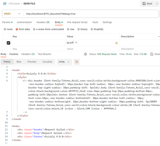

Trying to use the REST API service of the fscrawler. When using the POST MAN with PDF file, the app is answering with the 415 code - unsupported media type
Content-Type header is correct with application/pdf.
Using POST to the /_document?debug=true . Nothing in the log.
I think you need to use multipart/form-data.
Thank you. I have checked this according to the source code and changed the calling from postman. But now im getting stucked with error 500. In the log i can see just this line 2023-10-25 22:52:32 20:52:32,151 DEBUG [f.p.e.c.f.r.RestApi] uploadToDocumentService(true, null, null, null, ...)
Could you try with curl as in the documentation? I'd like to know if this "because of" Postman and then what needs to done.
with curl it is working
