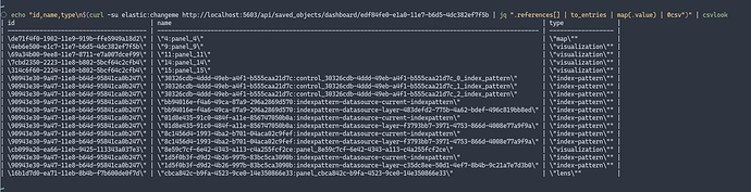

The response from the API gets a references array with all the relationships. Is that what you mean?
So for example from one of the sample dashboards relationships
If I query the get API and format the references objects, I get the same map, lens, index patterns, and so on:
Does this help?
