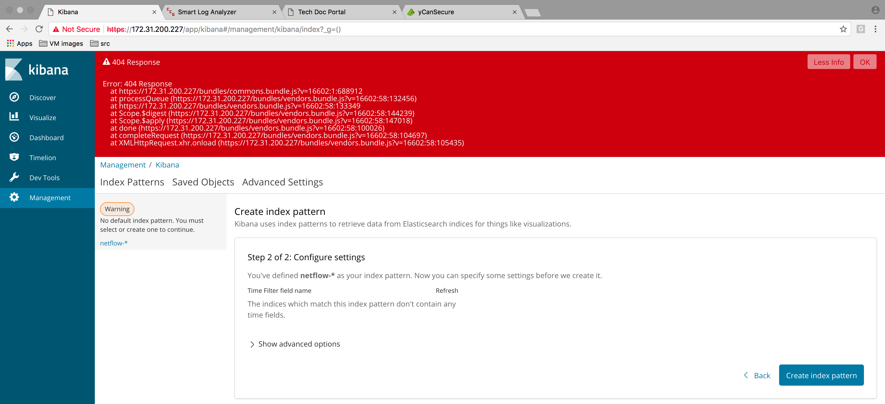

Get troubles in creating Kibana index pattern when the Apache proxy is up
I'm trying to put Apache proxy in front of Kibana and I have made a config file for apache. But when I start to create index pattern in Kibana interface, the 404 error prompts. From the first image, there is a match there and it should work. When I hit the next button, there will be an error there. I can see in the error it reports about /172.31.200.227/bundles/, but I have added the bundles in the proxy config file. Any suggestion? (BTW, the Kibana works fine without the proxy)

Have you tried setting server.basePath? https://www.elastic.co/guide/en/kibana/current/settings.html
Thank you! I changed server.basePath to "/kibana" and it works fine now.
