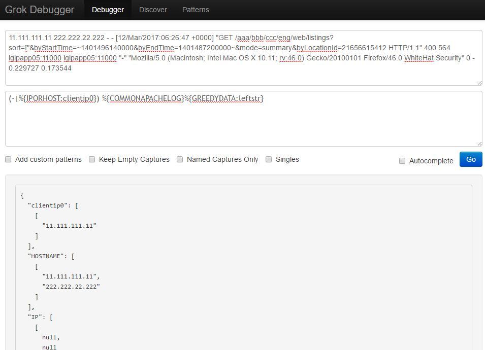

Grok parse failure. Why?
Input data:
11.111.111.11 222.222.22.222 - - [12/Mar/2017:06:26:47 +0000] "GET /aaa/bbb/ccc/eng/web/listings?sort=ї"&byStartTime=~1401496140000&byEndTime=1401487200000~&mode=summary&byLocationId=21656615412 HTTP/1.1" 400 564 lgipapp05:11000 lgipapp05:11000 "-" "Mozilla/5.0 (Macintosh; Intel Mac OS X 10.11; rv:46.0) Gecko/20100101 Firefox/46.0 WhiteHat Security" 0 - 0.229727 0.173544

match => { "message" => "(-|%{IPORHOST:clientip0}) %{COMMONAPACHELOG}%{GREEDYDATA:leftstr}"}

Grokdebug processes it without problems:

But I can not agree with you, because there are lots of successfully parsed events with \"GET.
In the same time ALL failed events contain any "strange" symbol, which seems belongs to another codepage
Ok, i was only going off the info you provided. In your post you had a message that was successful and a message that failed.
When i put the message that failed in grok debugger using your patterns, it did not parse. as soon as I removed the \ from "GET and the \ from HTTP/1.1" then it worked. If you have messages that contain "GET and work, please post them and i can compare them.
EDIT: Nevermind, i see i pulled the message from post filter which added those to escape the quotes inside json. my bad.
You might want to check the charset used in the codec for your file input and ensure it matches the encoding of the input log file.
