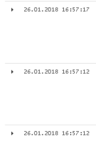

so I have a log with three entries.
26.01.2018 15:57:12 Hostname: ApplicationName : INFO - Message
26.01.2018 15:57:12 Hostname: ApplicationName : INFO - Message /configFile=Greedydata /logConfigFolder=Greedydata /step=Greedydata
26.01.2018 15:57:17 Hostname: ApplicationName : INFO - Message /configFile=Greedydata /logConfigFolder=Greedydata /step=Greedydata
And from the last two I got an grokparsefailure.
2018-05-16%2010_02_32-Discover%20-%20Kibana
The strange thing is, that the time is +1hour in every entry, where does that come from? The data in Kibana is parsed right through all three entries! So why is not every entry an grokparsefailure because of the time? And where else could that grokparsefailure come from?

Are you in CET? elasticsearch timestamps are always UTC. You can specify your timezone in the date filter.
Thats interesting!!! Ok, that could explain it. Yes I am in CET. But proove me wrong, I am trying to use the original LogTime thats why I am overwriting the timestamp where it has been send to the ELK and using the Log-Timestamp.
So what you suggest would assume that the UTC will be set on top of my logtime configuration, right?
elasticsearch uses UTC timestamps, and if you do not tell it otherwise then logstash has to assume your timestamps are in UTC. If they are in CET then add 'timezone => "CET"' to the date filter.
Ok now its the right timestamp thanks a lot.
I still got grokparsefailure. I thought it would depend on the timestamp but thats not true.
