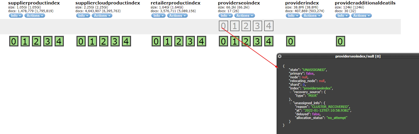

@dadoonet Thanks for your reply. I have set number of replicas to 0 but it still shows the unassigned shards on my providerseoindex can you please let me know is there a way to remove the unassigned shards.

Here is how i am creating my index.
elasticClient.CreateIndex(indexRequest.IndexName, c => c
                                  .Mappings(map => map.Map<ESM.Product>(tmd => tmd.AutoMap()))
                                  .Settings(s =>
 s.NumberOfReplicas(indexRequest.NoOfReplicas).NumberOfShards(indexRequest.NoOfShards)
                                         .Setting("analysis.analyzer", "str_index_analyzer")
                                         .Setting("analysis.analyzer.str_index_analyzer.type", "custom")
                                         .Setting("analysis.analyzer.str_index_analyzer.tokenizer", "standard")
                                         .Setting("analysis.analyzer.str_index_analyzer.filter.0", "lowercase")
                                         .Setting("analysis.analyzer.str_index_analyzer.filter.1", "substring")
                                         .Setting("analysis.filter.substring.type", "nGram")
                                         .Setting("analysis.filter.substring.min_gram", "4")
                                         .Setting("analysis.filter.substring.max_gram", "50")
                                         .Setting("analysis.filter.substring.token_chars.0", "letter")
                                         .Setting("analysis.filter.substring.token_chars.1", "digit")
                                         .Setting("search.slowlog.threshold.fetch.warn", "1s")
