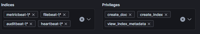

"type":"security_exception","reason":"action [indices:admin/aliases/get] is unauthorized for user [beats_setup] with roles [beats_setup,kibana_admin,ingest_admin,beats_writer,remote_monitoring_agent,remote_monitoring_collector] on indices [heartbeat-7.14.0], this action is granted by the index privileges [view_index_metadata,manage,all]"},"status":403}
But you can see here for the beats_writer role has the index permission shown
And the beats_setup role has these
