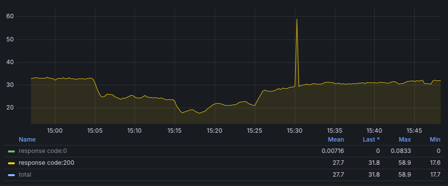

After setting up the index, I ran two services to test the performance:
  1. Indexing Service
  • This service indexed documents at a rate of ~1000 documents per second.
  • It started from 0 and indexed up to 5 million documents.
  1. Search Service
  • I started the search service when 3 million documents were indexed.
  • The search service is connected to Grafana to monitor query rates and response times.
Here are some additional observations:
  • While the indexing service was running, Elasticsearch segments grew from 0 to 680.
  • After shutting down the indexing service (at 15:18, as shown in the attached chart), segments started to merge gradually and decreased to around 80.
  • As segments decreased, search response times improved noticeably.
  • The lower the number of segments, the better the search response time was.
Regarding the additional question:
  • After the first query, subsequent queries were indeed faster, but the difference was not very significant.
  • Importantly, these queries were not repeated; each was unique.
If you have any further insights or suggestions to optimize this process, I’d greatly appreciate it!
Response time:
QPS:
