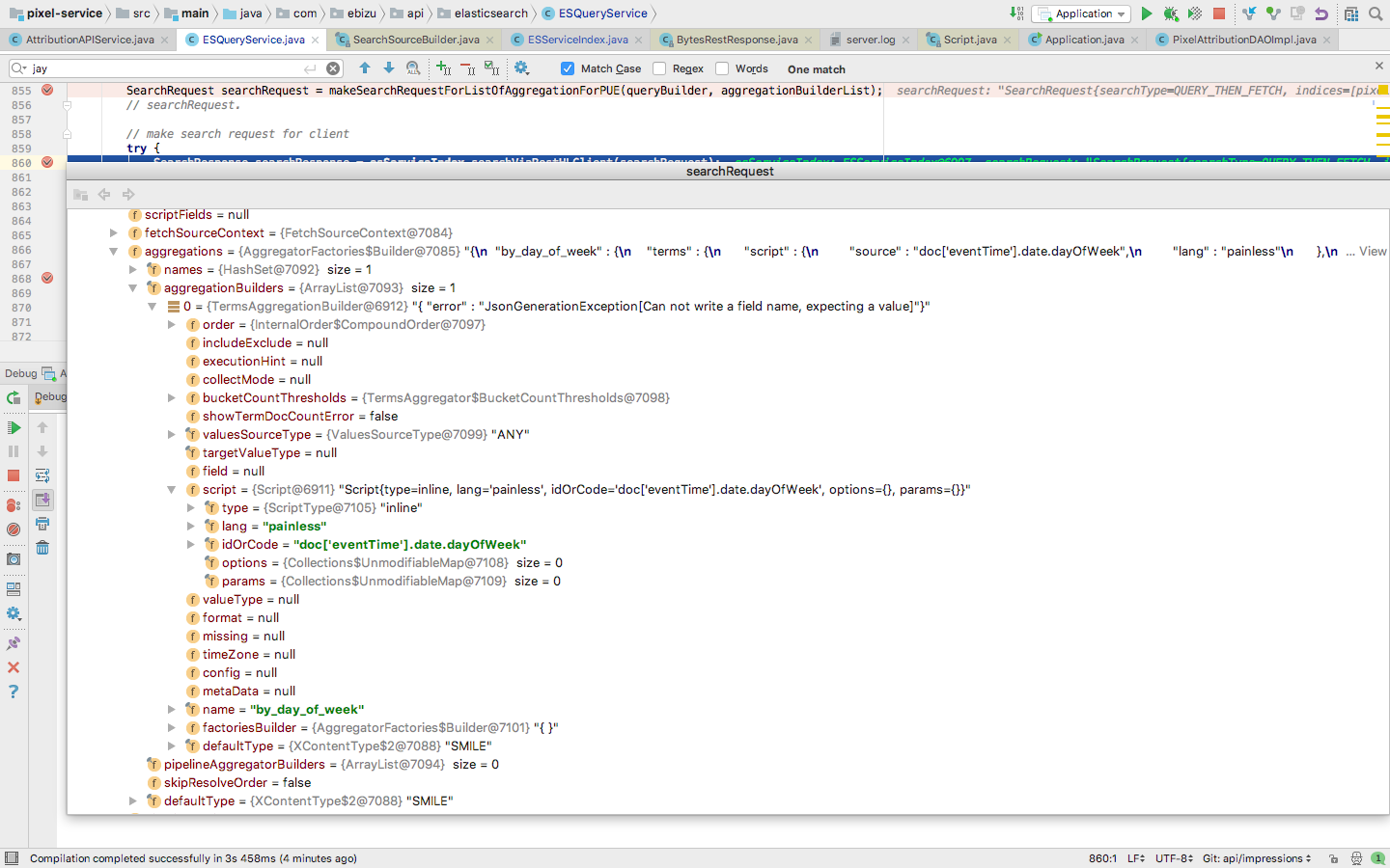

I was using the .script(Script) method of TermsAggregationBuilder.
But there is an error coming while searching the elasticsearch.
Please refer below code block.

@jpmiitian trying to reproduce, just to make sure I'm looking at the right thing: which HL client version are you using exactly and which version is the elasticsearch server that you are querying?
Hi @cbuescher
HL version is 5.6.2 and ES is 5
Which ES version exactly?
The problem is probably that the 5.6.2 client renders the Script class as the following Json:
	"source": "doc['eventTime'].date.dayOfWeek",
	"lang": "painless"
But older versions of Elasticsearch (I think everything older than 5.5) can only parse:
	"inline": "doc['eventTime'].date.dayOfWeek",
	"lang": "painless"
The renaming of inline to script was done in https://github.com/elastic/elasticsearch/pull/25127 and both parameter names are supported in 5.6 and the 6.x.
Your backend should be on at least 5.6. so this can work. In general, the HL client is supposed to be forward compatible, while there may be bw comp issues even for non breaking changes made to ES core.
Thanks @cbuescher for informing regarding the compatibility.
The ES version is 5.5,
I noted that below was working on kibana console.
{ "inline": "doc['eventTime'].date.dayOfWeek", "lang": "painless" }
Yes, it works as long as you specify the query manually and use "inline" instead of "source". The 5.6 client uses "source" when rendering the REST request though, since this is the preferred variant of the parameter name starting with 5.6.
