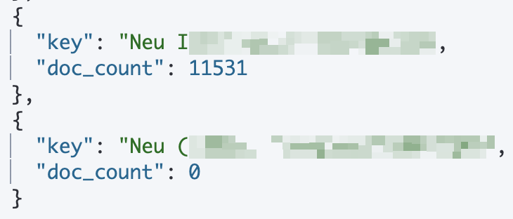

I get results with the wrong keyword and a doc count of 0:
How can I remove these incorrect entries altogether, such that this query will not return the wrong keyword?
