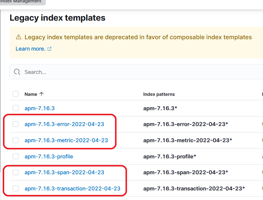

Hello @simitt
I tried the configuration, the Indices created were as per the way I needed them to be
Although now the Index template itself has a Date tag in it :
Is there any way to get the index template without the Date Tag? but get the indexes created with the Date and 0000n format?
Eg.
Index Template :
Pattern : apm-7.16.3-error*
Indices created by the above template :
Index name : apm-7.16.3-error-2022-04-23-000001
ILM : Same from my first config file.
For reference to get the output shown in the images I used this config :

No that is not possible, the index_suffix is also included into the template. Could you share your concerns and use cases for not including it?

As showed above, you can use the index_suffix to configure a date if prefered, but it will also be part of the template. Generally for the ILM configuration and rollover the date part is not necessary though.
Thank you for your inputs.
I'll configure the index without the Date suffix as of now then, since the ILM works even without them.
