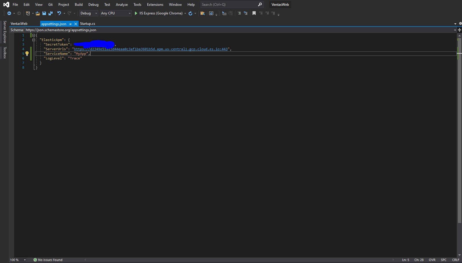

I have a problem adding the APM agent to my web application, I installed the agent from the NuGet, I created a class called 'Startup' as indicated in the documentation and also created the configuration file 'appsettings.json', configure as the documentation says with the url and token, I run the web application, but I am not sending data to my APM in kibana, I have already looked at several sources but I still do not know how to correct it, so I need your help please.
I attach screenshots of the code interface and the raw code as such:
Startup.css

appsettings.json
  "ElasticApm": {
    "SecretToken": "xxxxxxxxxxxxxxxxxxx",
    "ServerUrls": "https://d2349e51823d44eaa0c3af1ba3601b5d.apm.us-central1.gcp.cloud.es.io:443", //Set custom APM Server URL (default: http://localhost:8200)
    "ServiceName": "MyApp" //allowed characters: a-z, A-Z, 0-9, -, _, and space. Default is the entry assembly of the application
Hey @Juan_David_Jaramillo,
A good first thing to check would be the agent logs. Setting the log level to Trace in appsetttings.json with
  "ElasticApm": {
    "ServiceName": "MyApp",
    "LogLevel": "Trace"
will provide verbose information to troubleshoot with. If the application is using Microsoft.Extensions.Logging, the APM agent will create a logger with category name "Elastic.Apm" using the ILoggerFactory. If the application isn't using Microsoft.Extensions.Logging, the APM agent logger with log to Console.Out.
If you're able to provide some log output for agent operation, we can see what's going on.

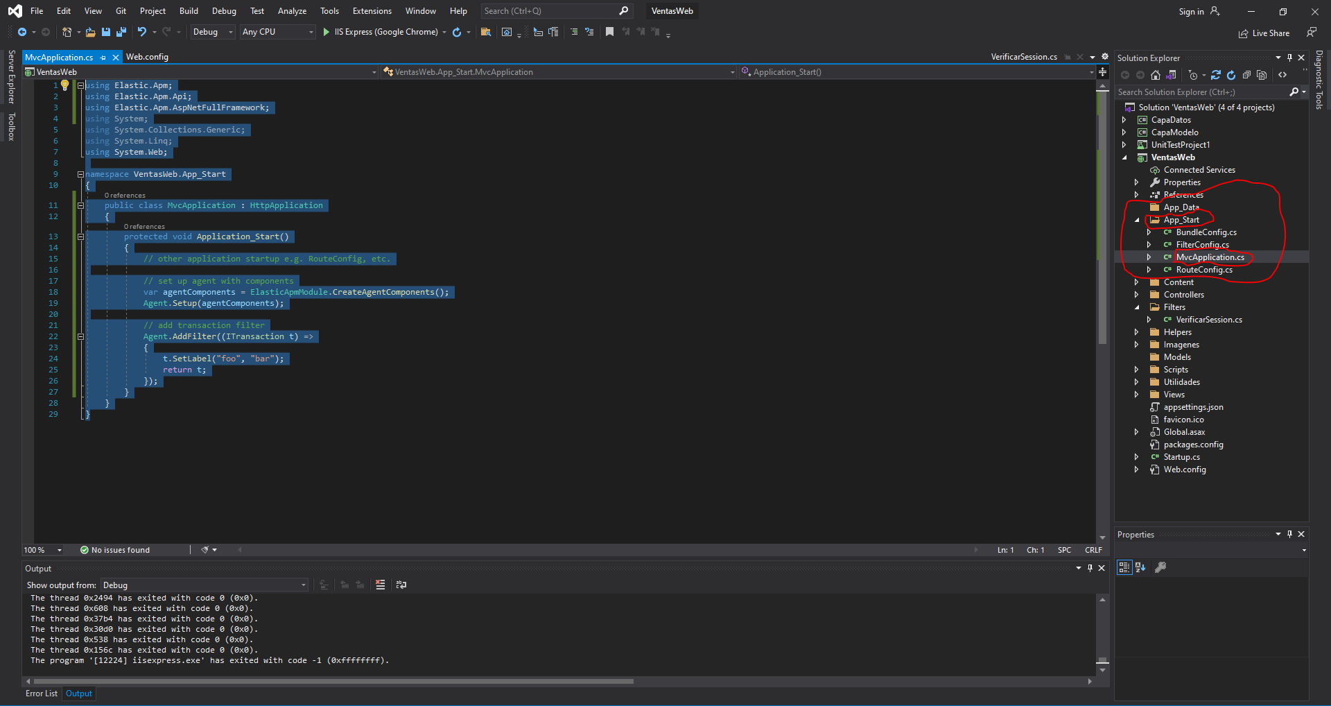

@Juan_David_Jaramillo is this an ASP.NET Core app, or a classic (old) ASP.NET Application running on full framework? :thinking:
I suspect this is a classic ASP.NET app on Full Framework since you say
In ASP.NET Core, those should be there by default, that's what makes me think maybe you are just looking at the wrong part of the docs.
Here is the relevant part for ASP.NET Classic (so the one which is not for ASP.NET Core).
ready, I have already done what the documentation says add the agent and run the application and everything is fine, but I do not know why I still do not get the data in kibana, this is how the config is:

MvcApplications:
I created a class in the app_start as it says in the documentation, I don't know if it is well placed.
using Elastic.Apm;
using Elastic.Apm.Api;
using Elastic.Apm.AspNetFullFramework;
using System;
using System.Collections.Generic;
using System.Linq;
using System.Web;
namespace VentasWeb.App_Start
    public class MvcApplication : HttpApplication
        protected void Application_Start()
            // other application startup e.g. RouteConfig, etc.
            // set up agent with components
            var agentComponents = ElasticApmModule.CreateAgentComponents();
            Agent.Setup(agentComponents);
            // add transaction filter
            Agent.AddFilter((ITransaction t) =>
                t.SetLabel("foo", "bar");
                return t;
I don't know if it goes in that folder
I think the issue is that this is an ASP.NET classic application, which won't pick up your apsettings.json file, therefore settings from that file are ignored. Again, if I understand the situation correctly, then you only need to follow this doc, and you don't need to follow the doc for ASP.NET Core.
Could you try to copy the ServerUrls and the SecretToken configs from your apsettings.json file into the web.config file similar to this doc?

{"ok":false,"message":"The requested resource is currently unavailable."}
The error log indicates that the resource at
https://d2349e51823d44eaa0c3af1ba3601b5d.apm.us-central1.gcp.cloud.es.io/config/v1/agents?service.name=VentasWeb_Clr4IntegratedAppPool
returns a 503 Service Unavailable response.
Double check that this is the url for the APM server and that the secret token is correct.
thank you all right, the token was wrong.
