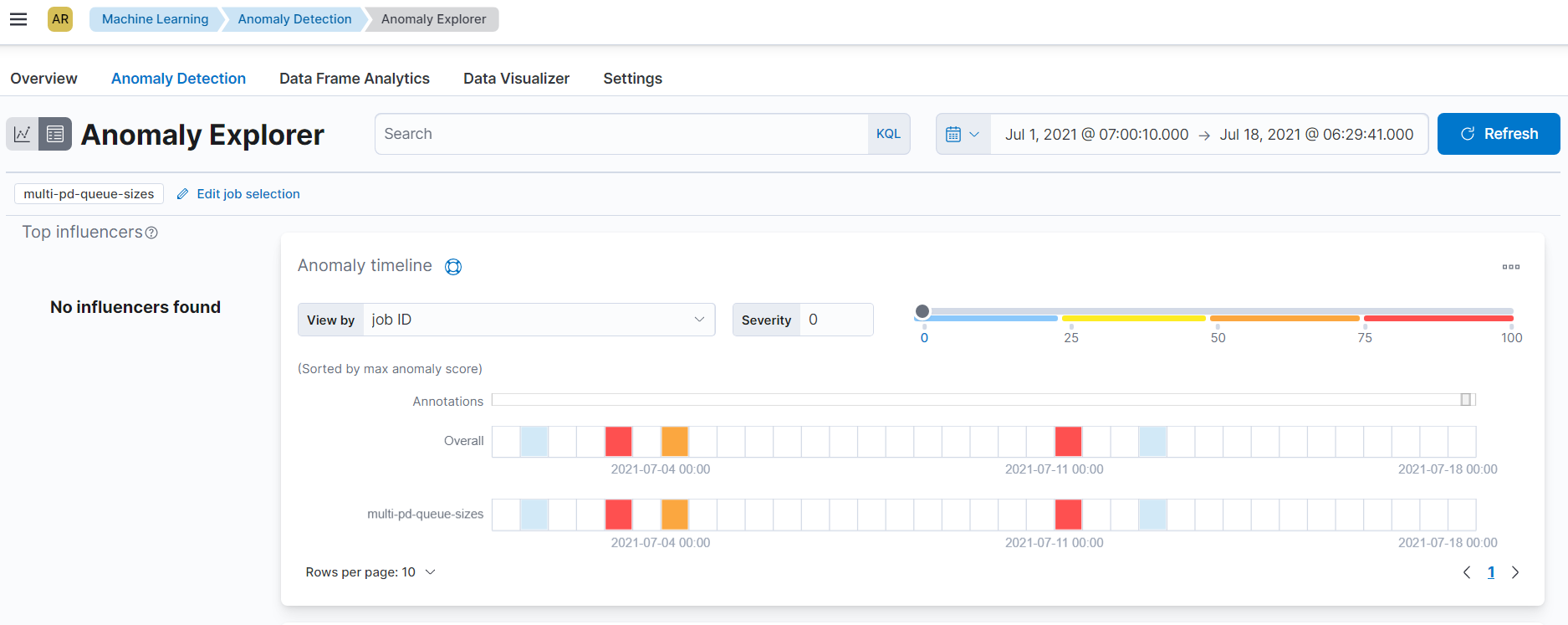

Hi @richcollier ,
I created separate jobs with specific query filter and now i am able to see the anomalies for different jobs for a given time frame.
  1. I need to understand how the overall score for a given time instance is calculated?
Like i am getting different values for each anomaly as shown in the picture but the overall is showing the score of the top one, is there any calculation being done or not?
  1. The influencer side is not showing anything for me.
I have 1 multi metric job where i used 3 influencers, but i don't see any.
the rest are all single metric job and i didn't see anyway to specify the influencer from the ui for those, so they don't have any influencer. I guess i would need to convert them into multi-metric jobs is that correct?
But before trying that i want to understand why my multi metric job is not showing any data?
Is it due to the insufficient data? what else could be the cause?
When i look at only the multi metric job where i have defined influencers even then i don't see any values.
One of the influencers I used for my multi-metric job "multi-pd-queue-sizes", is "slow-queries-n4center" which is indicating anomaly in the below picture at the same time when the "multi-pd-queue-sizes" is showing orange anomaly, then why the value of slow-queries-n4center is not considered as the top influencers?
Any help would be really appreciated.
Thanks
  1. First of all, read this blog to understand how scoring works: Machine Learning Anomaly Scoring and Elasticsearch - How it Works | Elastic Blog
  2. Influencers won't show if no particular value of a field was indeed influential. Single metric jobs if built with the UI don't have influencers because of the fact that behind the scenes, the data is pre-aggregated (not processed raw) and therefore any potential influencer information is lost. You can overcome this by creating the "single metric" job with the Advanced Job wizard and manually specifying influencers.
Thanks @richcollier
I went through the blog. Here is my understanding
After reading the 'Influencer scoring' my understanding is that the fields that i have been using for the influencers are not the perfect ones.
In the light of this example
"In an analysis of a population of users’ internet activity, in which the ML job looks at unusual bytes sent and unusual domains visited, you could specify “user” as a possible influencer since that is the entity that is “causing” the anomaly to exist (something has to be sending those bytes to a destination domain)."
It made the influencer sounds like a 'category' to me, more than another data point that may get anomalous itself.
whereas,
I think the fields that i am using as influencers are just other data points like cpu-usage-percentage, free-memory, num_Slow_queries, db-slowness, index_fragmentation_count etc.
where the value may vary all the time. The value may fluctuate and we cannot guarantee a specific value.
So, In my opinion they cannot be used to group the records where the anomaly were found.
Is my understanding correct?
If not then, Can an influencer be any other numerical data field? If yes then, if the value may vary all the time then can it still be useful to measure its impact on the detector's anomaly?
Based on my understanding my conclusion is,
I shouldn't use them as influencer. Is that correct?
If it is correct then the question is what i should use as my influencer?
I would need to think about it.
In real time they can be my influencer (means they are the other factors that i can put blame on for the anomalousness of my detector, they may not be the single root cause of the problem but somehow collectively they might've put their share in the problem ).
If i didn't sound crazy and can get answers for my questions then may be that would help me in finding the right influencers from my data set.
If i do sound crazy then i guess i need to do more reading.
Thanks for time anyways.
Yes, influencers should be categorical fields (like "user" or "host" or "location", etc.) but should NOT be numerical fields (response_time or cpu_utilization, etc.)
