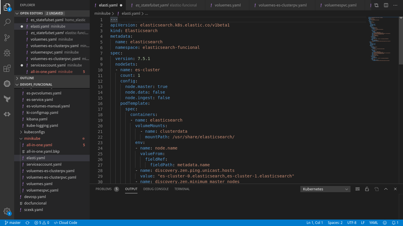

I create the configuration nfs now on elasticsearch resource, look my configurition pv,pv and of elasticsearch.
Elasticsearch#

I am trying to create a separate master and data cluster. But I'm getting the error that is unable to bound pvc mapping.
#ERROR#
Warning BackOff pod/elasticsearch-es-es-data-0 Back-off restarting failed container

When I am trying to start the Elasticsearch master and date cluster I get the unbound persistentvolumeclaims error. How do i get pvc in the same pods as elasticsearch eck k8s. He functional in hospath normally when i create nfs he give me unbound persistentvolumeclaims error. Is it possible to have us claimName on the same pod?
  • Unless you have a good reason to do so (like no volume provisioner), you should probably not define PersistentVolumeClaims and mount them in the spec yourself. Instead, you can just declare the claim template. ECK and the StatefulSet controller will take care of creating the PersistentVolumeClaim based on that template automatically. See this doc.
  • You don't have to set discovery.zen.ping.unicast.hosts, discovery.zen.minimum_master_nodes and node.name. ECK is already doing that for you.
